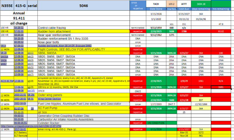

the problem is, most don't know how to sign off an AD, 12-08-06 has 10 levels, several of which are 12 months or 100hrs, others are 36 months, and one is 4 years. all too often I see CW AD 12-08-06, with no next due date, and no listing of what was done, here is an example of the way I do my sign offs CW AD 12-08-06 Flight controls, IAW (g) (1) (9)
SM56 and 35A para (g) (1) and (9) due 3/2027 or 3794hrs, (g) (
due
2/2029.
As far as ADs, I use the FAA web site, when you do a search by airframe, you have the option of saving the search as a excel spreadsheet, I use that as the basis of my AD program, I have it set up to track all the ADs, and due times and dates as well as giving days and time remaining. see the attached photo
