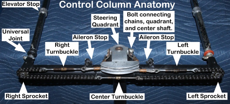

Converting to a D has NOTHING to do with the firewall!! It’s the skin that covers the cowl tank. It must be stainless. It also has nothing to do with the gas tank. You must:
Put a stainless steel skin over the gas tank
Make sure the orifices in the MLG are correct
Limit elevator up trsvel to 9 degrees
Have the ¾” trim tab
I believe these are required for the 1320 STC with the possible exception of the stainless steel skin.
