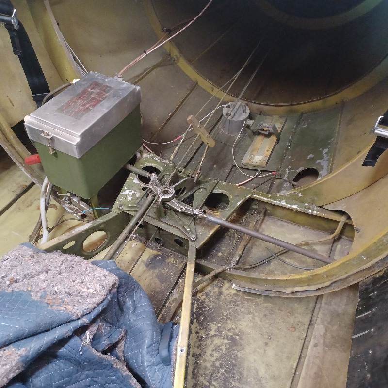

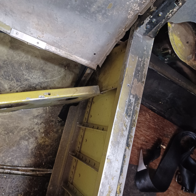

Good morning, I am looking to redo/fix the area under and behind the seats and behind the side panels to the yellowish green color, is this Zinc Chromate Green and is there a premixed version? Or is there a Zinc Phosphate that is about the same color? Currently Tweety is a mix of different paints from over the years. Anyone have experience repainting these areas?
